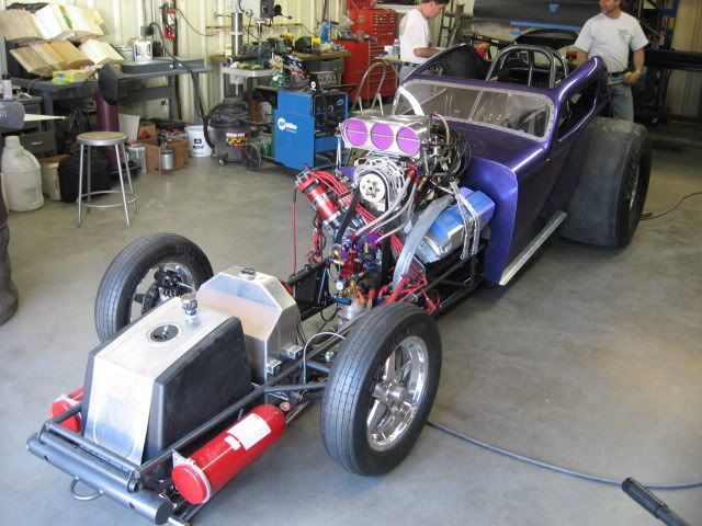

Postby Solid Rock » Thu Apr 26, 2007 4:39 pm
Rapid, Is the lever on the left side, hanging down from the frame rail the fuel shut off?
Postby Rapid Randy Baker » Thu Apr 26, 2007 4:47 pm
On the left side is the fire bottle lever.
On the brake handle is the fuel shut off.

Postby Solid Rock » Fri Apr 27, 2007 6:20 am
Rapid, The reason I asked about that lever is that a friend of mine had his fuel shut off mounted there and he found, after having some expensive problems, that his leg was closing it part way when he would operate the clutch pedal during the burnouts and leave.
I know you don't have a clutch yet, but it is something to keep in mind for the future.
Postby Rapid Randy Baker » Fri Apr 27, 2007 2:41 pm
Rocky there are a number of guys who have done that very thing,,,quite a bunch of guys put a piece of duct tape on it to hold it open.
Good point to bring up Thanks. 8)

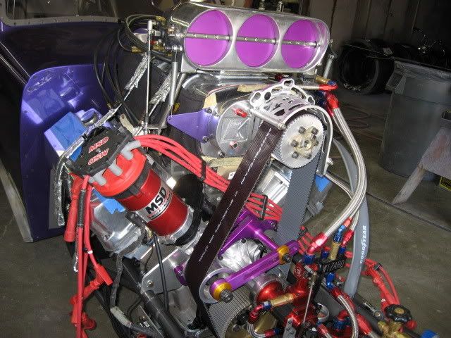

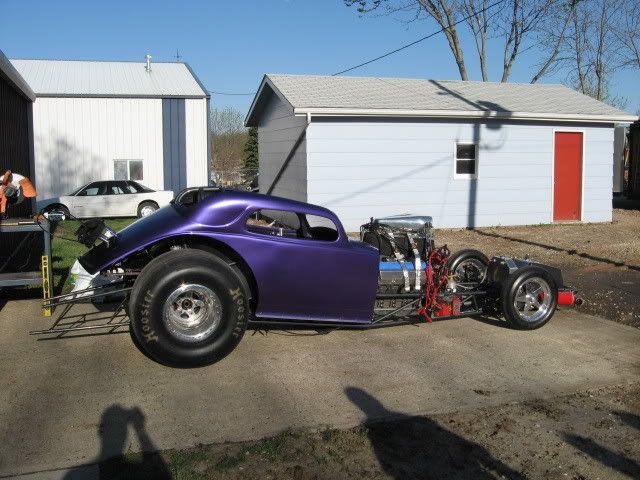

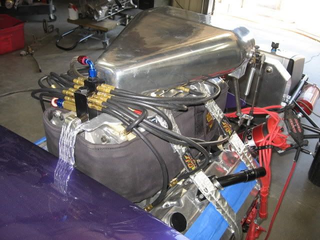

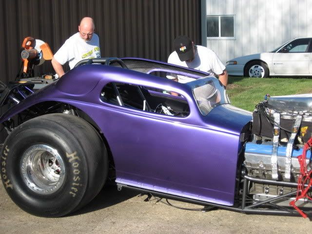

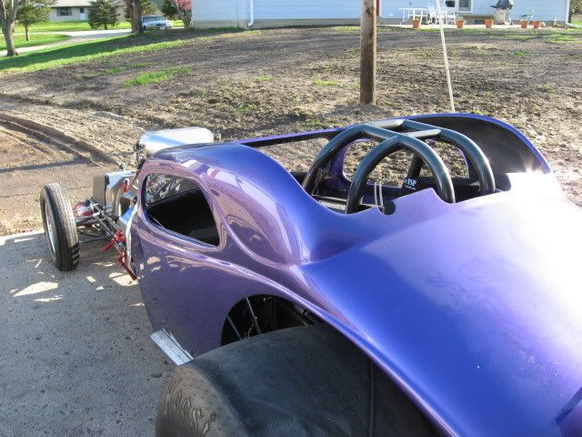

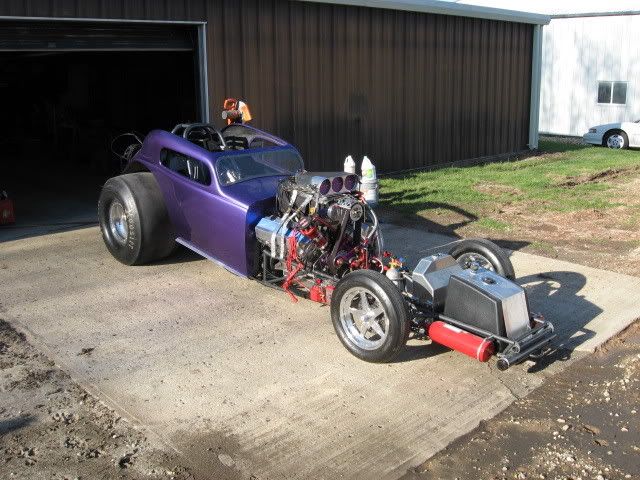

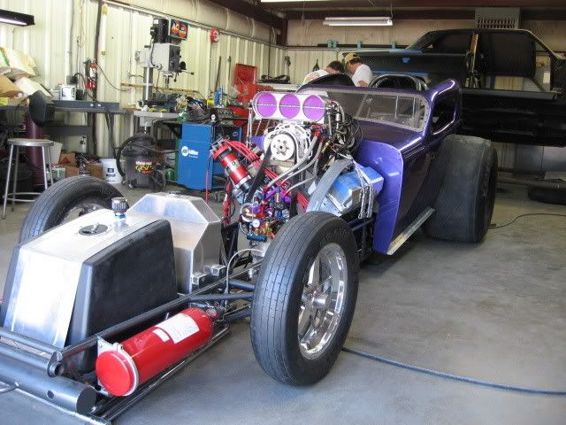

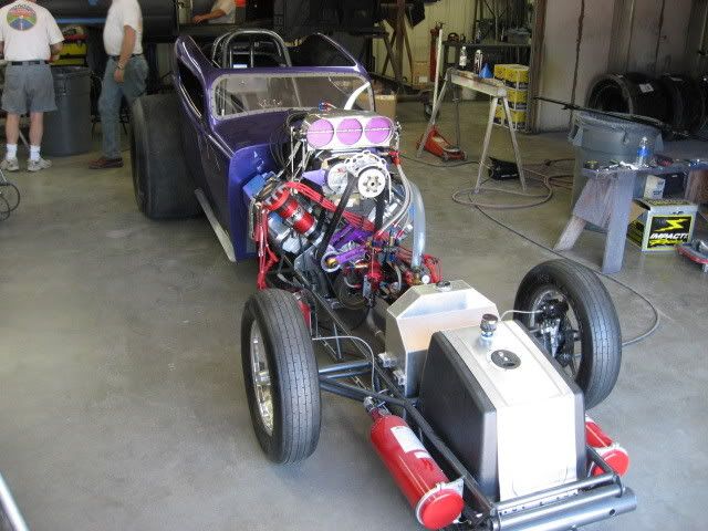

Postby Rapid Randy Baker » Sun Apr 29, 2007 1:56 am
Here are a few more photos from this weekends updates. 8)

Postby Solid Rock » Sun Apr 29, 2007 6:18 am
Looks great Rapid!!
