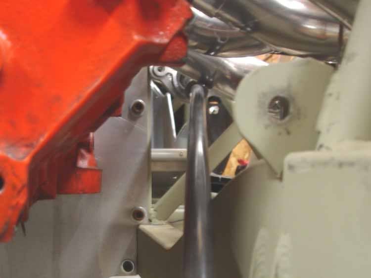

Got a question. I've got the steering column installed and everything set in place to see how it fits. Fits purdy' snug actually. It comes within about a 1/2" of the header, but it's just the shaft not a joint, so I think that will be O.K. My question is, I have about 1/4" clearance at the frame rail. Do you think that's enough? It's a mild steel chassis, so I don't expect there will be too much chassis flex? Even if there's some I don't know if it would be a problem based on the angle of the steering shaft to the frame rail. But, I could be wrong so that's why I'd like to get some opinions.
Close up of frame rail to shaft clearance.
From the R&P looking back to the firewall.

That looks a little close to me, but experts have the last word.
What stands out the most is you're keeping an open mind about it and asking the rest of us for advice on it...this car is good...life is good. WC1

That is fine i know plenty that are closer then that and No problems...nothing will move that much

Thanks Dennis. I'm gonna' go with it....(When my back ordered parts show up that is).
