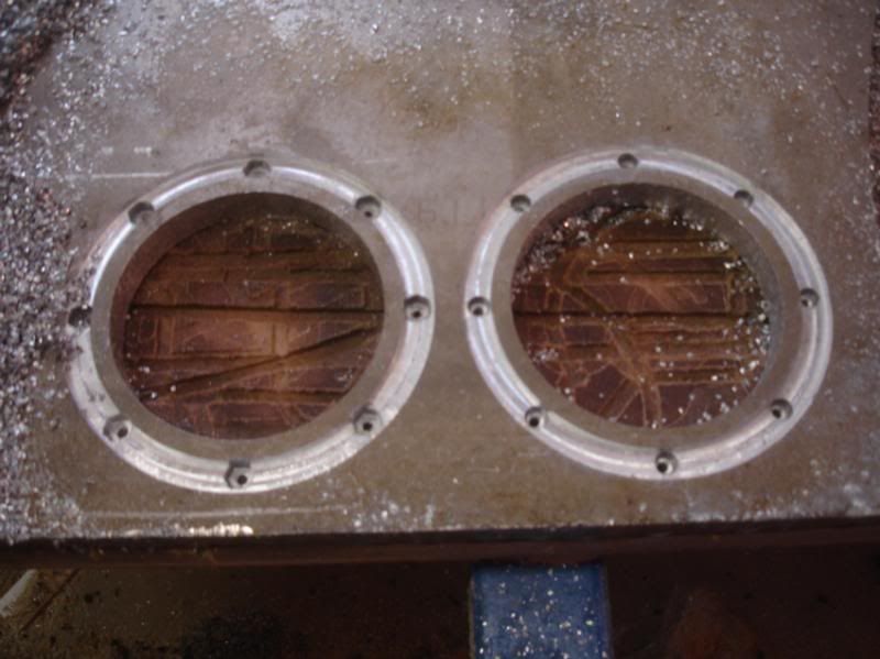

The more I LQQK at the intercooler in this pic. I'm thinking I might change the outlet tube connection to a bolt together joint instead of the hose clamp set-up. I can see that thing blowing off taking the dash with it. That might be bad for me knee & ears too. :shock: :idea:

:D Gary i know nothing about turbo cars but a little about burst panels in fibberglass...... i like the hard connection you are contemplating

I had some time this weekend so I decided I'd get the hose & clamp set-up replaced. I pulled out the old slab of aluminum and started whittlin' away.
I countersunk #6-32 cap screws. I didn't want to trust that size thread in aluminum so I countersunk nylocks in the other half of the flange.
Flipped one over & cut an o-ring groove
cleaned them up on the lathe & cut the mating surfaces for a nice air tight fit.
Finished and ready to install.
Postby pro70z28 » Sun Jul 05, 2009 10:24 pm
My aluminum welding skills aren't the best, but I got 'em melted together.
Intercooler side with o-ring
all bolted together and back in the caah.
dash cover back in. No more hose & clamps.
That's what I did this weekend. :D
